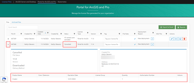

Hi Sarah,
Glad to hear this.
Editing a license file will cancel the current file you are updating; therefore, your previous license file can no longer be used. If you need to reference it to determine what licenses were previously provisioned, you can do so by expanding details on the old license file in MyEsri:
In this screen capture, the File ID 447368 is my original license file which I've edited. Note the status is cancelled. The File ID 447369 is the edited license file.
Thanks,
Kait
