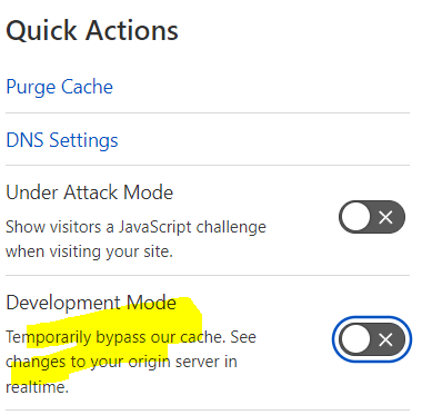

Interesting so maybe you want to try this... I wonder how long "Temporarily" is -- maybe until you turn it back on? This affects the entire domain, which might or might not be bad for you. The popup when you turn it on says (in part) "Cloudflare will continue proxying traffic to your origin server without caching any content."

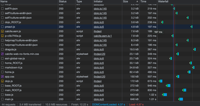

i already tried that but i noticed the latency is very high when requesting web page files and scripts

Yes WHOA that's bad. Now I have to test this to see what it does to me! Looks like you are hitting a WAB app.
