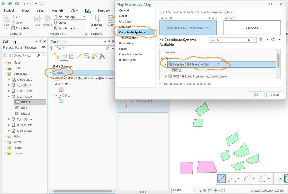

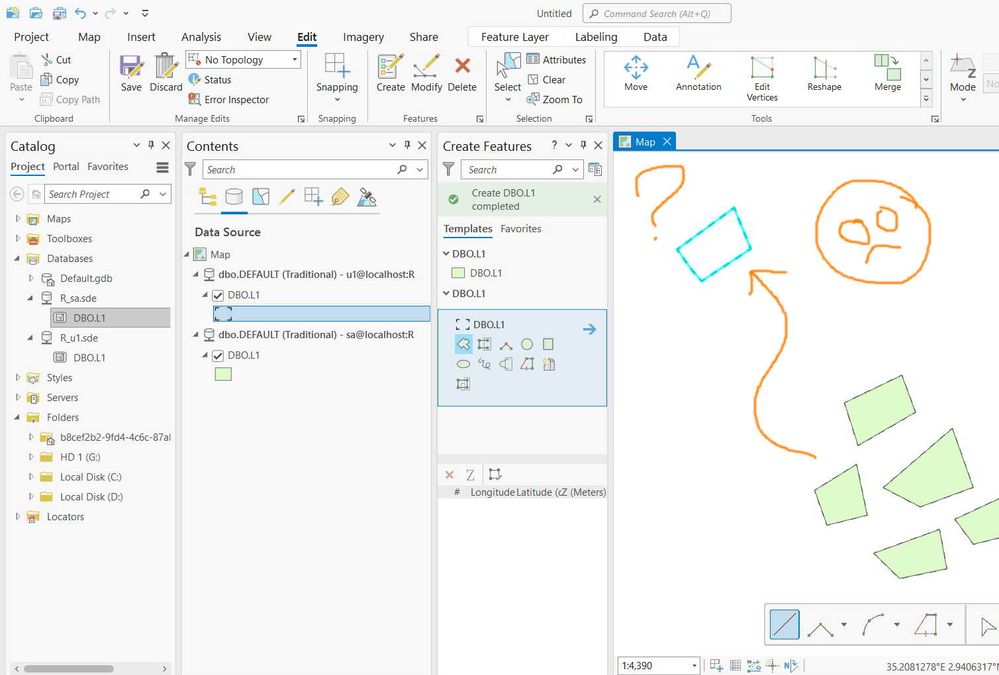

I couldn’t figure out why digitizing a polygon feature gets moved up in its own when finishing it

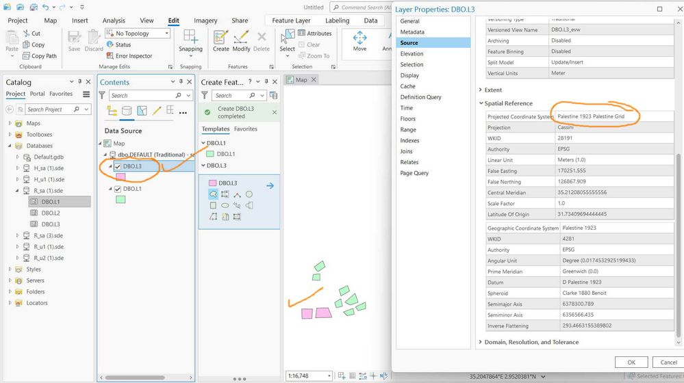

It appears that the issue here is due to the spatial reference inconsistencies between the map and the layer. Having the layer in the same coordinate system as the map resolves the issue.
L3, for example, doesn’t have this issue as it has a projected coordinate system
