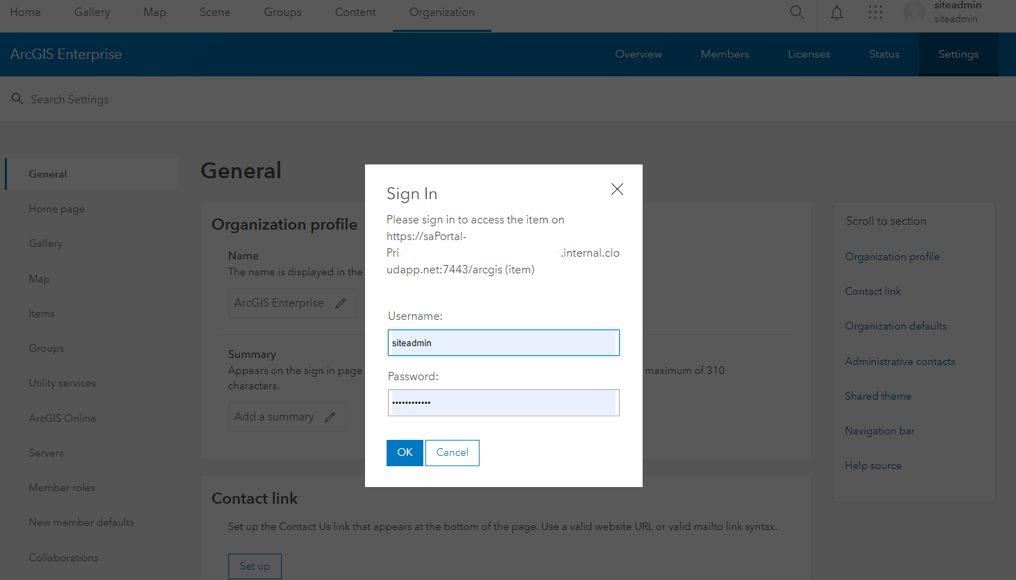

Hello,
I just finish fresh new installation of ArcGIS Ent. on Azure. I used "ArcGIS Ent. Cloud Builder 11.0 for Ms Azure" Version 11.0.35046
After successfull deployment I login to portal and get login screen when I open the setting page. I did not notice any  degredation or problem on portal.
Do you have any ideas to get rid of this issue?
I use below configuration options:
Deployment type: Multi Machine Multi Tier
From Esri Image:- Yes
Image Name:- ArcGIS Enterprise 11.0
Total Machines:- 5
Machine Names:- saFileShare, saServer-0, saPortal-Pri, saDataStr-Pri, saJumpox
Enable OS Updates:- No
Remote Desktop:- Yes (Port 0)
ARM Resource Prefix:- sa
Preserve artifacts:- Yes
Use Cloud Storage:- Yes
Cloud Storage Option:- Azure Files (SMB)
Uses Azure Monitor Logs Workspace:- Yes
Capture Server Logs:- Yes
Automatic VM Shutdown Enabled:- No
Portal Context:- portal
Server Context:- server
Site Administrator UserName:- siteadmin
ArcGIS Service Domain Account:- False
File Share Option:- On Single Machine
File Share Host:- saFileShare
Data Store Types:- Relational
SSL Option:- CA Issued Certificate

The additional popup box is asking you to sign in to the application server using port :7443 rather than going through true HTTPS.  Can you log in to:
https://your.domain.com/portal/portaladmin/system/properties
and see if you have a webcontexturl set?  If not then I'd recommend implemeting it.  Essentially it forces all portal traffic to occur over the 443 address rather thatn 7443 address, which is a good thing.  Instructions are here:
https://enterprise.arcgis.com/en/portal/latest/administer/windows/using-a-reverse-proxy-server-with-...
You need to be appending a JSON snippet along the lines of:
{ "WebContextURL": "https://your.domain.com /portal" }
In essence, most of your web requests appear to be going via 443, but occasionally it's swapping to 7443, and the above configuration should stop that from happening.

Hello @Scott_Tansley ,
Thank you for your answer.
webcontexturl and privateportalurl already set by cloud builder setup as below.
{"WebContextURL":"https://your.domain.com/portal","privatePortalURL":"https://your.domain.com/portal"}
I did try another setup with same configuration to ensure that there is no error on Cloud builder deployment, unfortunately get exactly the same problem on second deployment.
Suleyman.
I am planning to go with manual setup if I can not solve this issue.
