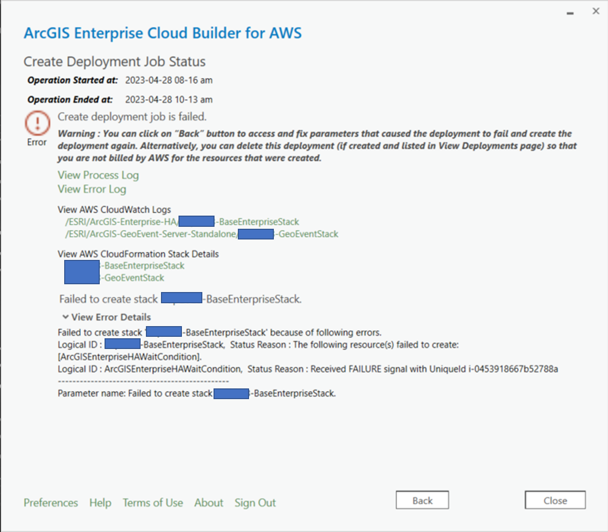

Hi,
We're using the enterprise cloud builder to deploy into AWS/Azure. Thus far, we've done single server deployments and have not encountered problems doing so.
However, we have a new requirement for a HA deployment and have encountered issues.
Currently, we have 2 main questions relating to the error encountered.
  1. As this is a HA setup in AWS, do we need 2 licenses? If so, how do we request for a prvc file with 2 licenses in MyESRI?
  2. What's the proper follow up when encountering the error cited above? We'll probably be looking at the cloudformation logs. But we're unsure if this is the anticipated follow up by cloudbuilder to remediate the issue.

From this error message I suspect that you haven't configured your DNS CNAME record properly to point to the ALB DNS record. More information can be found here if that is the case.

yes - the cloudformation error log is a good place to start with the trouble shooting.
All we can see from the screen shot is that there was an error after 2 hours - so that sounds like it was almost there.

JosephSia2
The following issue observed in cloudformation logs for BaseEnterprise Stack.
ChristopherPawlyszyn
-- Chris Pawlyszyn
JosephSia2
Yes. That was indeed the issue. Enterprise was successfully deployed after i sorted out the DNS configuration. Many thanks.
