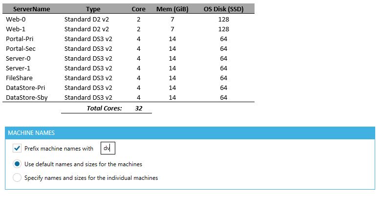

Thanks for the question, but after a lot of digging Esri and I found the real issue. Cloud Builder has requirements that our Microsoft Azure subscription for development environments didn't support by default. It is the way my company set up the Azure EA. Anyhow, It appears my deployment wouldn't work because of the machine sizes I was choosing were too small to meet the default requirements of ArcGIS Enterprise. I didn't sit down and compare machine sizes in Azure to the minimum requirements for each product, therefore unsupported machine sizes would cause Cloud Builder to not finish all the configuration. At least that is what we think at this time. Esri deployed a default configuration in their Azure subscription and it worked as expect. I will be doing the same thing in my environment once my Admin ups my Azure requirements to meet the Esri standard. Very frustrating to have go through this all, but in hindsight I should have thought about the VM sizes and figuring that part out.
Esri created a chart for the default configuration machine sizes so I could ask our Admins to set up my subscription to support the architecture. I have included it on the post.
Default Configuration
