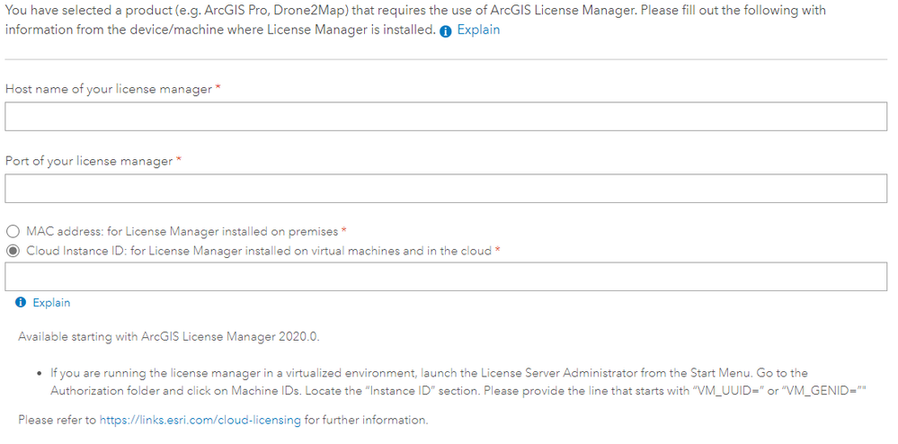

We have an EC2 Instance we'd like to use for our LSA so that users can utilize ArcGIS Pro without being inside of our network. According to the March 2020 update to this whitepaper, licensing through a cloud machine should be possible now.
The Problem
When I try to generate a license file in My Esri, I am required to supply the host / domain for the machine in the format machine.domain. Looking at the Machine IDs window in LSA on the EC2 instance in question, the host and domain names appear to be the same.
According to the documentation in My Esri, what I'm looking for is the fully qualified domain name. That, from what I can see in other forums and support documents, is the EC2 instance's Public IPv4 DNS, which does look a little more like what I'm expecting.

When generating the license file for Portal, did you select the Cloud Instance ID when you got to the license manager page?
jcarlson
MVP Alum
Yes, I used the Cloud Instance ID, including the "VM_UUID=" bit.

KFitzgerald
On your Portal Admin Page > License > Bottom of page > Update License Manager >
  •  {"hostname": "licensemanager.domain.com,backuplicensemanager.domain.com","port": 27000} all in JSON
OR
  • Example: {"hostname": "Machine Name, Static IP", "port": 2700X}
  • Port of where your license manager is setup, your case 27000.
This is assuming your license file is correctly setup. I used my VM Machine name when generating the license file along with the Cloud instance ID and got it to work on my AWS EC2 instance.
https://developers.arcgis.com/rest/enterprise-administration/portal/update-license-manager.htm
