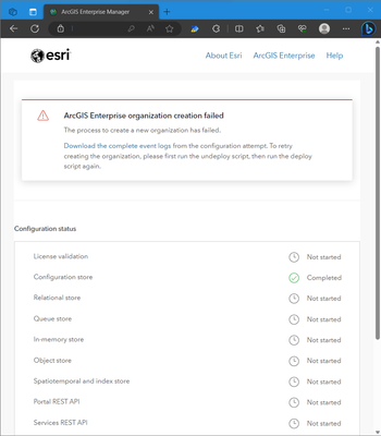

I'm trying to set up and configure version 11.1 but have encountered issues setting up the organization. For some reason the process is failing when it tries to set up the dynamic persistent volumes. It does manage to set up the dynamic persistent volume for the configuration store however.
Would anyone have any pointers to what i should look for? It's rather confusing when it works for one but not for the others. Log output attached.

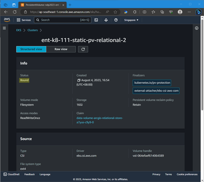

Just an update that static provisioning of the persistent volumes doesn't make any difference. Am pretty much stuck and will likely need to reconsider using this. 

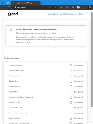

Am still getting the following final logged Warning after 5 minutes of running where it fails and I have no clue what the issue is.
2023-08-04T09:20:30,315|WARNING|35e76aaa-d56a-4ba9-97b3-992bfccf0c90||Enterprise Admin|1084|1|14|ElasticSearchManager|Managed spatiotemporal and index store is accessible but not ready to use yet. Timed out(60m).||

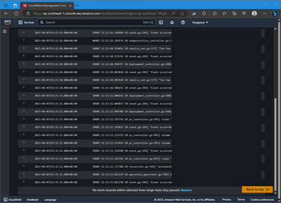

Spent the day plugging away at it. Turned on logging for EKS to try to understand what is occurring but to no avail.

As expected, one of the statically provisioned Persistent Volumes has been bound for the config store. But it still doesn't give me a clue about what is wrong.
