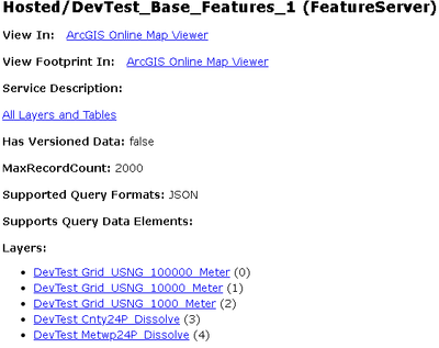

Here's a suggestion.  In your ArcGIS Pro project map, in the contents, highlight all the layers you want to group in one service, select Share, Web layer, Publish Web layer.  Looks like this when you are done.  Of course, my example is a hosted feature layer, but your referenced service should look the same.

As @Todd_Metzler mentioned earlier, you should be able to use Pro to select multiple layers in the map, and share them grouped together in a single service to ArcGIS Enterprise. This includes feature services which reference data stored in an Enterprise Geodatabase. Pro can then be used for editing these layers. Feel free to reach out if you have any questions. Thank you!
