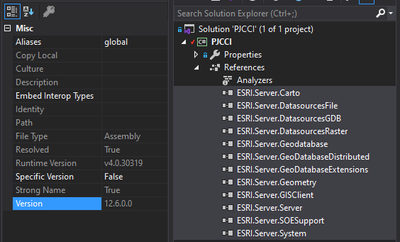

The SOE (built from a new SOE project is Visual studio) is using the ArcGIS Enterprise SDK for 10.8.1 but after deploying it, I am not able to restart the service in which it was activated. I am getting this error:
It seem the server is expecting the ESRI dll at version to be at 12.6.0.24234 but all my references in VS 2019 are using dlls at version 12.6.0.0 (located in C:\Program Files\ArcGIS\EnterpriseSDK\DotNet).
I changed the "Specific version" property for these dlls to false but it does not work either.
