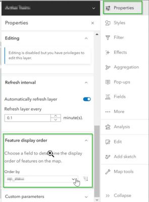

So, although the layer draw order is not supported directly by the web feature layer, the draw order is able to be applied to the operational layer within a web map.
this setting is controlled directly in the web map by the 'Feature Display Order' property:
https://enterprise.arcgis.com/en/portal/11.2/use/set-feature-display-order.htm
