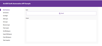

After Earth launching, you can also try the  Earth automation API samples via this URL in your web browser "http://localhost:8000/sample/index.html",
