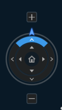

For now, if you want to adjust the tilt after the auto-zooming, we suggest you use the on-screen navigator. You can check the Settings-Navigation-Enable navigator control. After then you will be able to use the navigator in the bottom right corner.
