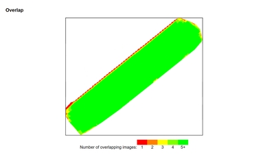

I'm processing my orthomosaic and the distance within my images isn't correct. Flight had 80% overlap for front and sides.
Say I have the distance between 2 GCPs as ~72.6m, but my ortho is measuring ~444.5m  in Drone2Map. Also, some distances within the image can be correct but then next to it, can be ~100m off. Can anyone offer any reasons this would be happening? It happens whether I import GCPs or not.
Also, when I process the ortho alone, the report Preview looks fine, but once I process the DSM and DTM, the figure gets this strange artifact to the left of the image. I've clipped the processing to the extent of 5+ images in the overlap figure.  
