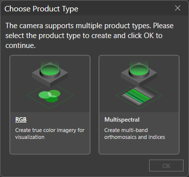

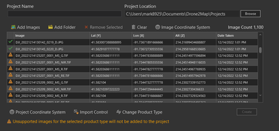

What you have heard is correct, when imagery is loaded into the new project window from a camera that supports different outputs (i.e. RGB, MS, thermal) we display a pop-up that allows you to select the product type you want to process.
This automatically filters only the images that match that product type and you will see a notification that this has happened.
Are you not seeing the product selection pop-up?

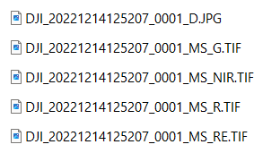

The typical naming convention for the Mavic 3 MS drone would have the filenames that look like the following:
NIR bands are not going to process by themselves in Drone2Map. The camera model expects the other bands (Green, Red, RedEdge) to properly generate the orthomosaic.
