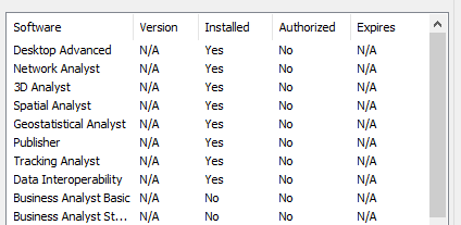

Having issues authorizing.

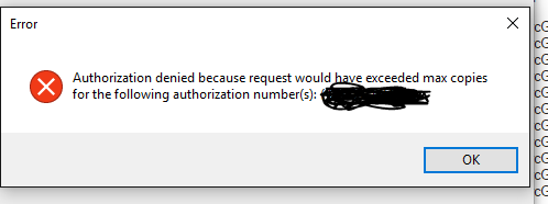

Installed 10.4 on Windows 10 Home.  I select the ArcGIS Advanced Single Use and it fails to authorize.

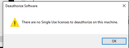

Some times it fails to connect through the internet when my connection is just fine.  Other times it says the license has already been registered but nothing is.  I can't deauthorize either because nothing is actually authorized.

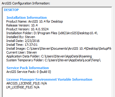

Does it matter that I installed ArcGIS on my D drive and FlexNet is running on my C?  Attached is the event log.

So, looking at the FLEXnet event log your actually seem to have a viable TrustedStorage authorization cycle--the paired event 40000005 and 40000003 for each process and thread representing a launch.
What causes you to think you are not authorized? Could you post up a screenclip of your ArcGIS Administrator initial panel, and also a screenclip of both the Desktop panel and the Availability panel.

When I go to Authorize, it has never given me the successful authorization message.  It has always failed.  I'm tempted to reinstall on the C drive to see if that affects anything.

You can try an install to C:,  but a 😧 drive installation should be fine. I don't believe it will make a difference.
