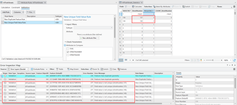

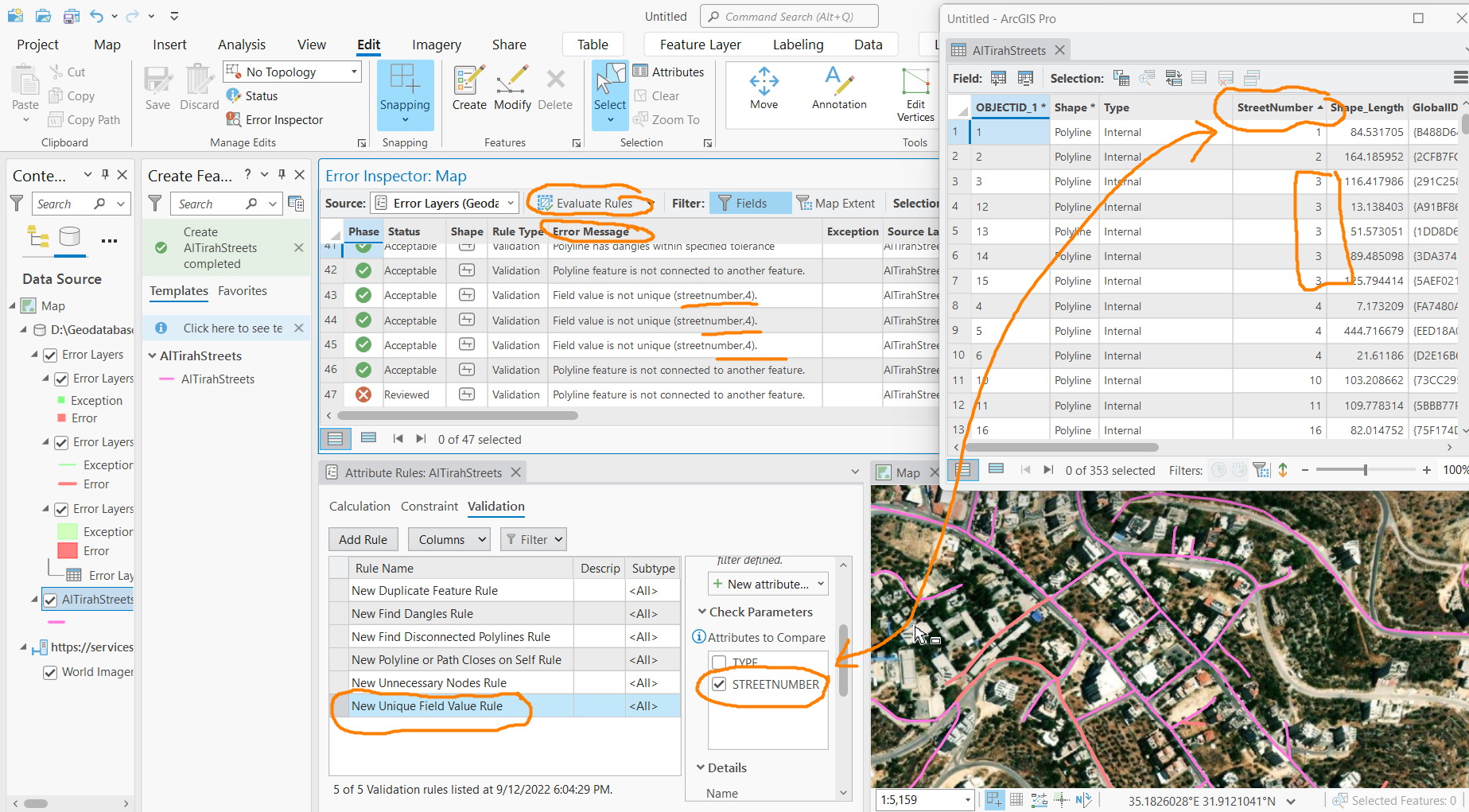

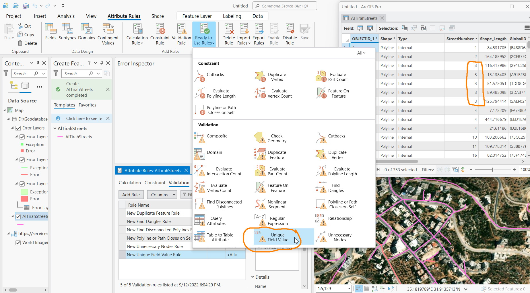

In the screenshot below, the “unique field value” ready to use validation attribute rules fails to identify the streets that have #3 despite the fact that the “evaluate rules” is performed
What could be the issue here?

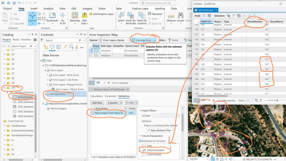

The Unique Field Value check appears to be working as expected (ArcGIS Pro 3.0.1) when used with the sample data (Z91.zip).
Note:  The data contained in Z91.zip does not appear to be the same as that depicted in the above screenshot. For example, the AlTirahStreets feature class contained only one rule (New Duplicate Feature Rule) and the features with duplicate STREETNUMBER values are different.
I completed the following steps to verify that the check is correctly ignoring the VALIDATIONSTATUS field during evaluation:
  1. Modify a feature (oid 348) to create a duplicate STREETNUMBER (<NULL> to 1) value.
    1. Modified feature's VALIDATIONSTATUS changes from NO VALIDATION REQUIRED to VALIDATION REQUIRED.
  2. Click Evaluate features command (using Full Extent option).
    1. New errors identified where feature contains STREETNUMBER = 1 and VALIDATIONSTATUS equal either NO VALIDATION REQUIRED or VALIDATION REQUIRED
    2. VALIDATIONSTATUS updated to NO VALIDATION REQUIRED, HAS ERROR(S)
If your results are different, I would suggest contacting technical support for additional troubleshooting.

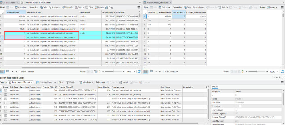

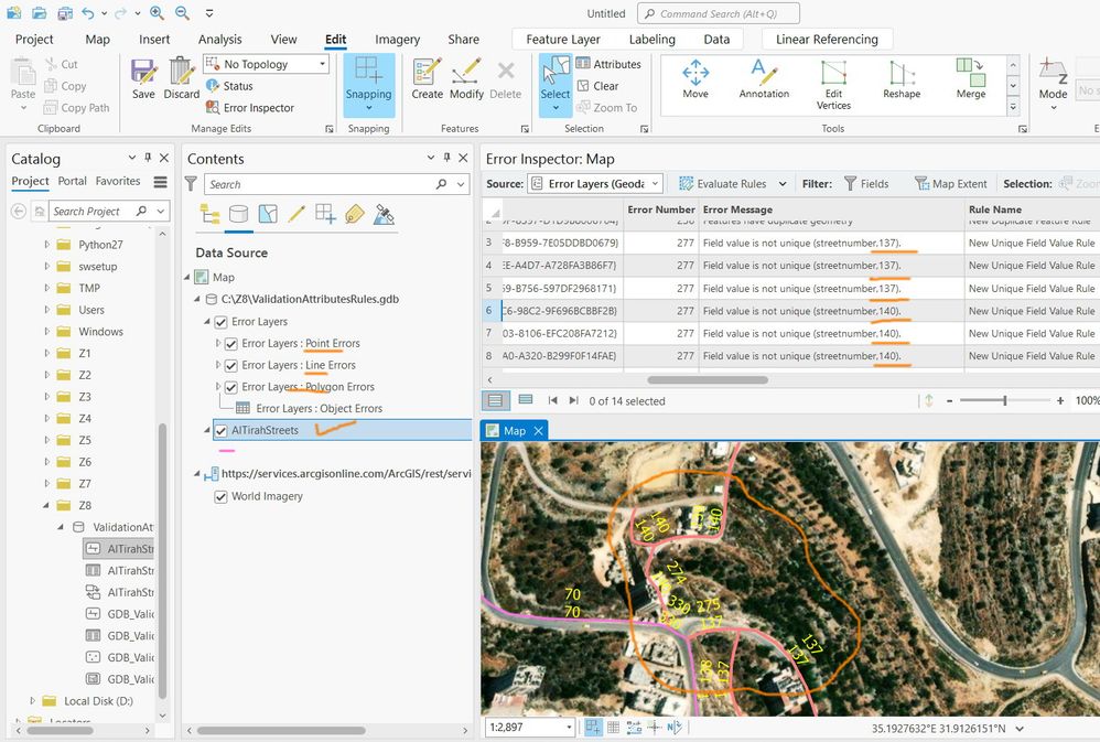

It gets worse. The validation attribute rule fails to detect the “unique field value rule” as per the screenshot below (the data is attached)
What could be the issue here? is this a bug?
