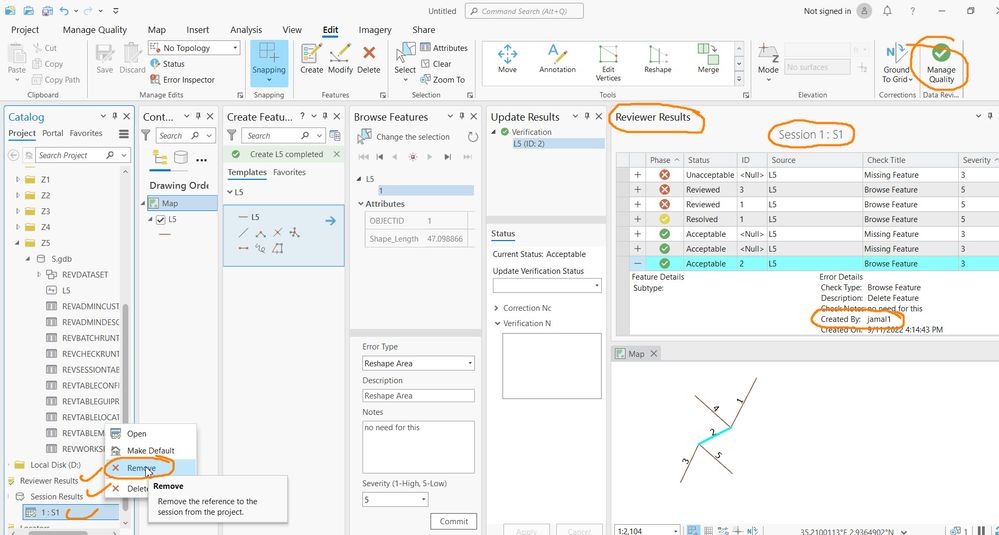

In the screenshot below, the “S1” session is created by “jamal1”. Now, how this session can be ended and started by another user, say “sami” as it used to be performed in ArcMap

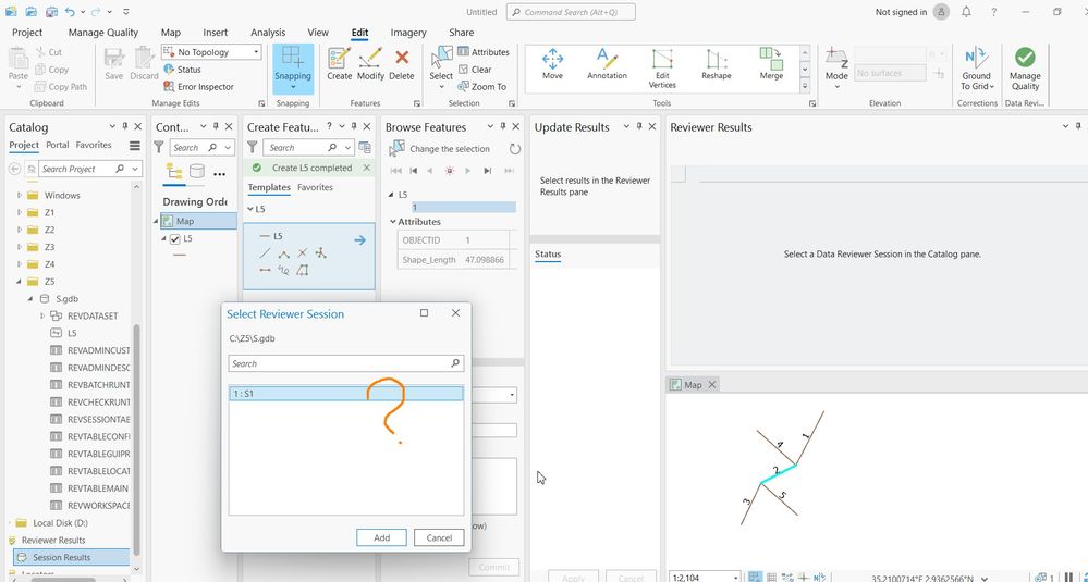

Here is a topic that outlines the workflow for adding Reviewer sessions to an ArcGIS Pro project.

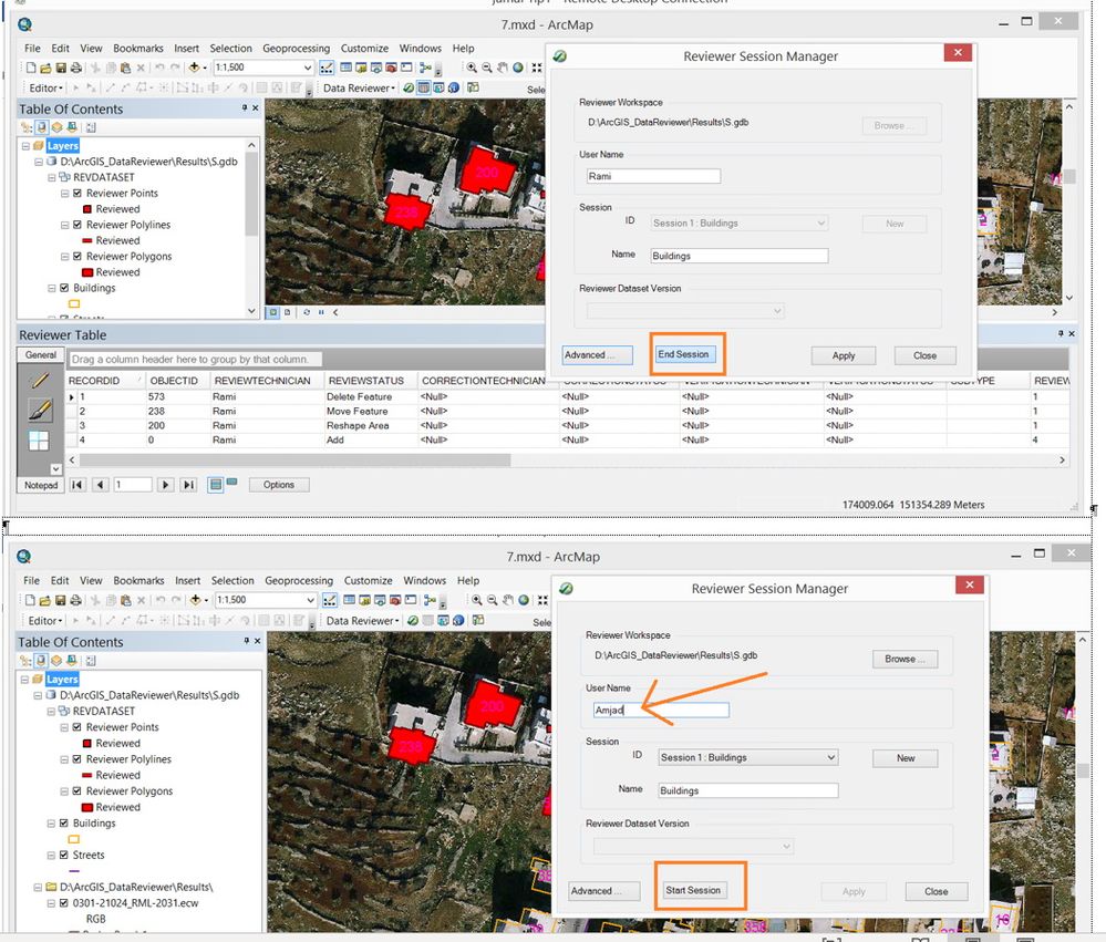

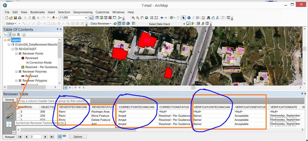

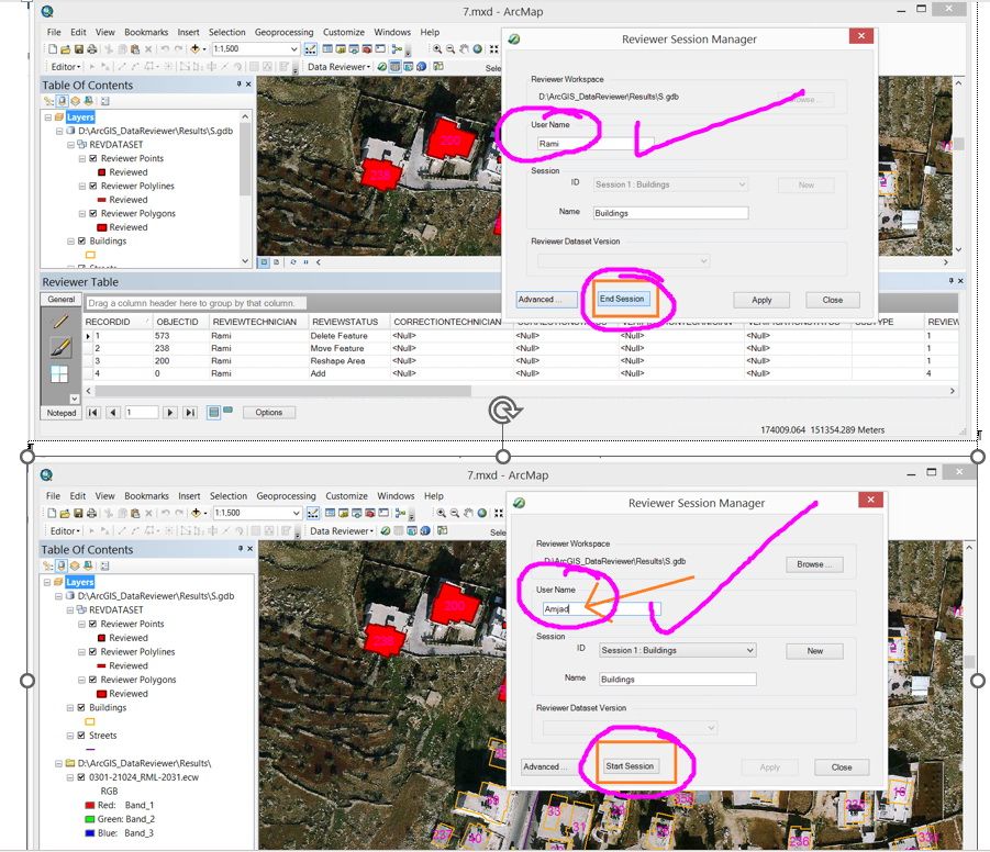

In ArcMap, the has been an option to access a session with a user name of our choice. This functionality appears not to be available in Pro. The user name of a particular session is stored and displayed as per the screenshot below
