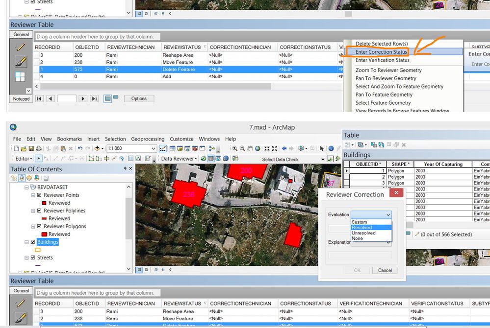

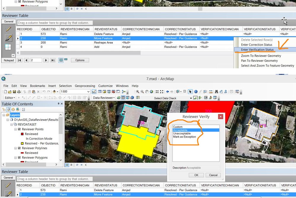

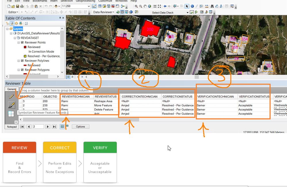

In ArcMap, the reviewer, corrector, and validator are used to commit their work as per the screenshot below. I’m not sure how this can be managed in Pro

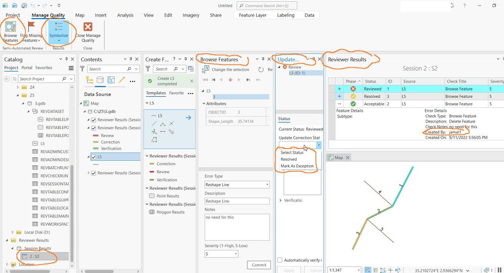

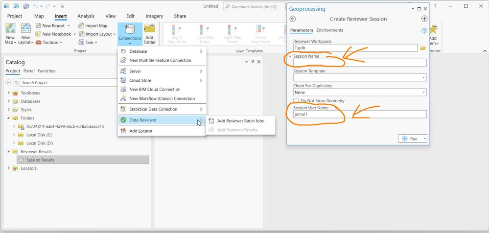

The lifecycle management workflow for Reviewer-created errors (in both Batch Job and validation attribute rule workflows) is the same as it was in ArcMap (albeit in a different user experience). This topic outlines the various "paths" that are available in the different phases.
JamalNUMAN
Legendary Contributor

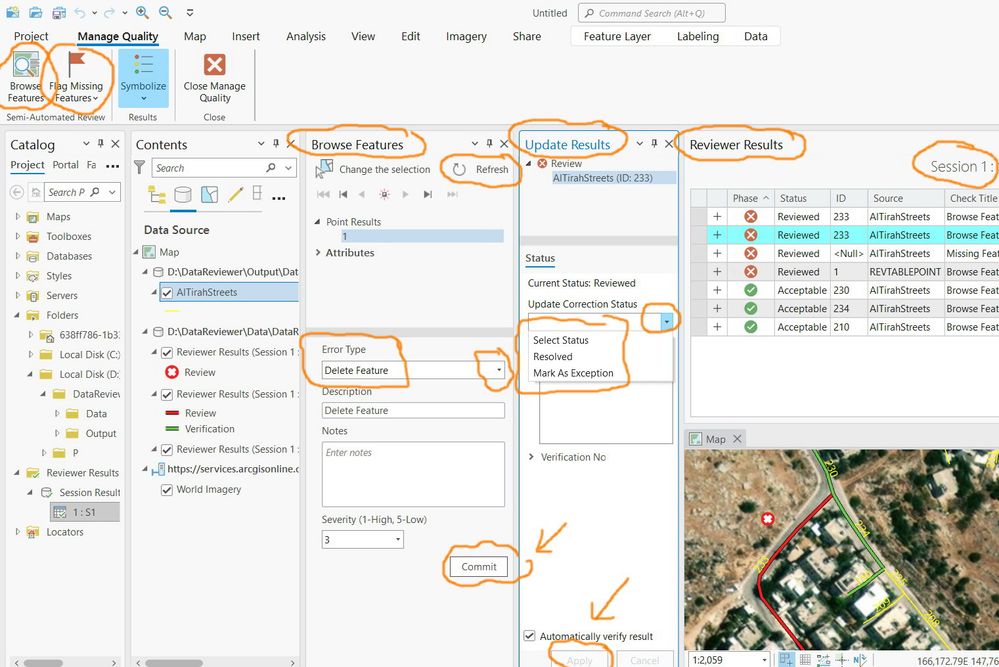

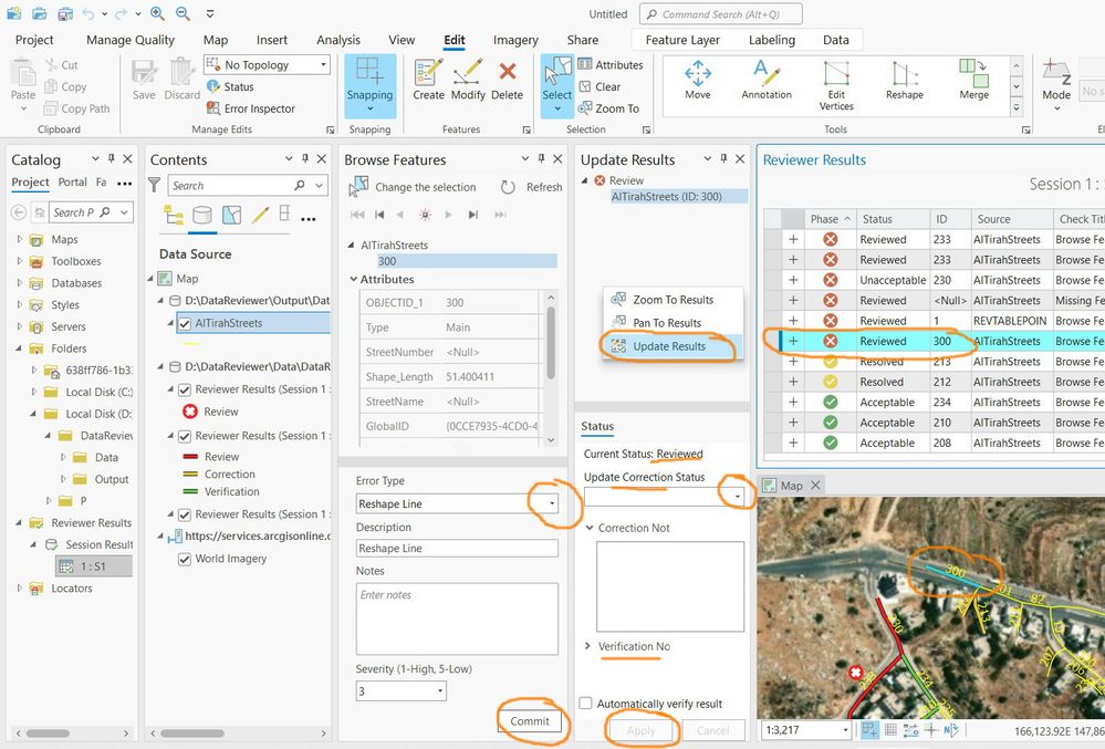

  1. The “browse feature” tool is used to select the features where they are committed with the “error type”. The “flag missing feature” tool is used also to report missing features.
  2. These committed errors are displayed as records in the “reviewer results” session table
  3. The records are corrected and verified with the “update results” tool
