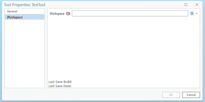

After clicking OK etc then looking back into the properties I see the below.

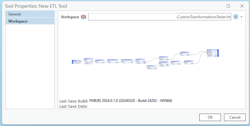

Hi Renato, Yeah I see the same running window. When it finishes and I open up the tool again, I get what you see in the second image above. On a new fmw file I get the same behaviour.

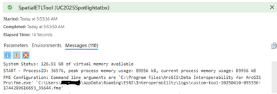

Just to state the obvious, have you tried Opening ang Running the ETL tool from the GP pane? Did it run and does the messages in the Message tab show any results, similar to the below? Scroll down to look for the Start - Process ID tag.

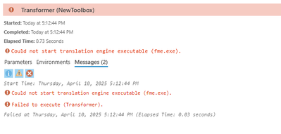

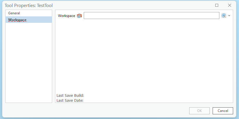

After I select the existing workspace, then OK everything. I try and run the tool and there are no parameters. If I run it nonetheless, I see this. I then go into the properties and the workspace I selected isn't there and the 'Workspace' option on the left is underlined in red.

This confirms that the fme.exe command executable does not have the required fmw file parameter configured with the ETL tool.  Please submit a support issue and refer to this question in your case specifying as well if its reproducible in new projects or new atbx. I'll keep an eye on it.
Is the FMW file created from a version different from the current Pro 3.3.1 you are using?  There may be validation checks on the DI version to display that thumbnail. Let me check with our dev.
