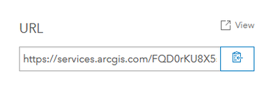

To do this, in your browser and logged in as the service owner, go to the Content section in the Home app and navigate to the feature service item.  At bottom right is a control that lets you View the item REST API:
Go there in your browser (your URL will of course be different).
https://services.arcgis.com/FQD0rKU8X5sAQfh8/arcgis/rest/services/Get_It_Done_311_Requests/FeatureSe...
To access the admin API insert the word 'admin' between 'rest' and 'services':
https://services.arcgis.com/FQD0rKU8X5sAQfh8/ArcGIS/rest/admin/services/Get_It_Done_311_Requests/Fea...

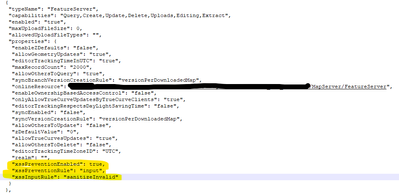

Now search for the xssPreventionInfo property, set the value for xssInputRule to sanitizeInvalid:
Click the Update Service Definition button and check it completes OK.  Now you can write HTML and things like <somebody@hotmail.com> to your feature service!

Please select all the JSON in the Update Service Definition form and replace it with this:
    "xssPreventionInfo": {
        "xssPreventionEnabled": true,
        "xssPreventionRule": "InputOnly",
        "xssInputRule": "sanitizeInvalid"
Let us know if it fixes the issue - thanks.
