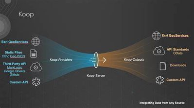

Take a look at
Custom Data Feeds | ArcGIS Enterprise SDK
or if you don´t have the latest ArcGIS Enterprise Version: Koop (koopjs.github.io) (same as custom data feeds, but not tightly integrated into ArcGIS Enterprise)
As you already wrote, you could code a script to get your API Data into a feature Service utilizing ArcGIS Notebooks, then schedule the Notebook
There is also ArcGIS Data Pipelines is Now Available (esri.com) now (quite new, so you need to check if it supports your use case)

N0MAD
Thanks, that was exactly what i needed
