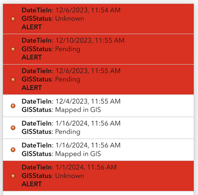

The result looks like this:

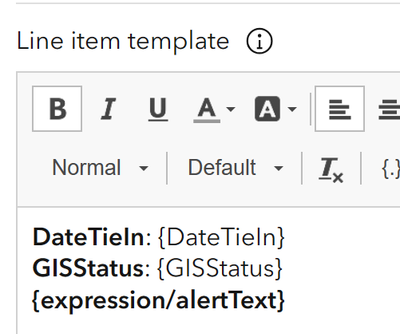

Here's how the Line item template is configured:
