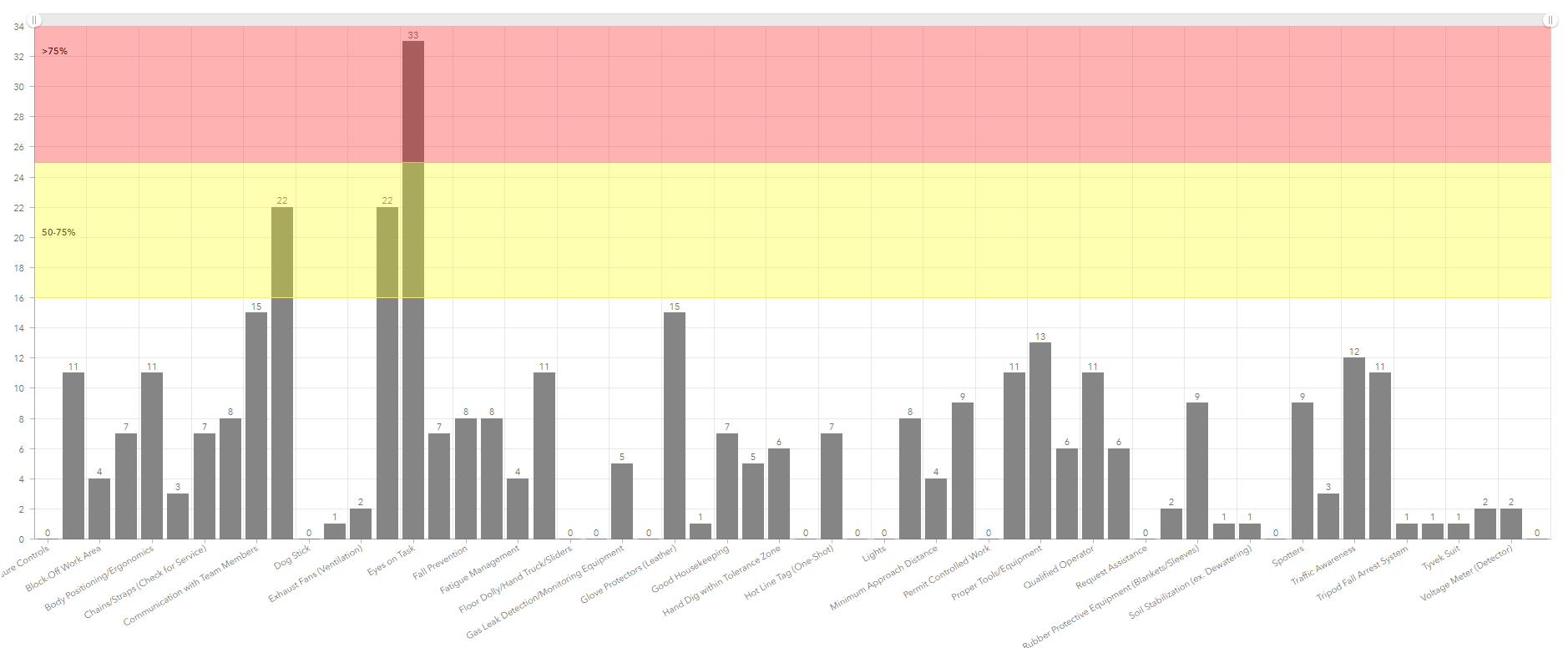

I created a serial chart, with categories from fields.  While the chart shows record count, I'd like to include percentages of overall records, either as a label or using guides.  Is there any way to do this?
If using guides, I'd like something like this:

Thanks for the reply.  A little more detail...
I have a Survey123 form, with a select_multiple field.  I also created individual numeric fields for each of the selections that is auto-populated with a "1" if that value is selected in the select_multiple field.  The serial chart is comprised of these individual fields, and sums the value of these fields to return the total # of times an option was selected (this was the only way I could get a count of each individual selection).
This is all being done in an enterprise portal, and it looks like that option to do a data expression is only in AGOL.  Looked at a pie chart; but, with over 80 items I'm trying to report, it's a little busy.
In additional to the above, I'd really like a way to sort by record count, as I've been asked several times to view the "top 10 most selected items", but creating a serial chart from individual fields won't allow that.
