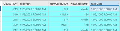

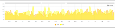

While the FeatureSet code suggested by @DominicRobergeIADOT looks promising, I couldn't make it work for me.  Instead I created a SQL view that somewhat creatively uses a calculated field "fakeDate" to push all the data into a single arbitrary year (1,000 AD to avoid potential confusion with any "real" datetime) and pushed the COVID New Cases for each year into separate attribute fields.  I published this view in a service and using this approach I can show the different years as series on a single chart and "fakeDate" as the Category axis.
SQL View table:
Dashboard Serial Chart:

SELECT ROW_NUMBER() OVER(ORDER BY reportdt ASC) AS OBJECTID, reportdt, NewCases AS NewCases2020, null AS NewCases2021, DATEADD(year, -1020, reportdt) AS fakeDate
FROM COVID_CASESTABLE WHERE
(reportdt BETWEEN '2019-12-31' AND '2021-01-01')
UNION ALL
SELECT ROW_NUMBER() OVER(ORDER BY reportdt ASC) AS OBJECTID, reportdt, null AS NewCases2020, NewCases AS NewCases2021, DATEADD(year, -1021, reportdt) AS fakeDate
(reportdt BETWEEN '2020-12-31'AND '2022-01-01')
This might get a bit cumbersome if we end up tracking COVID for 10 years, but in the meantime this was a quick, relatively simple workaround, if admittedly involving a bit of smoke and mirrors...

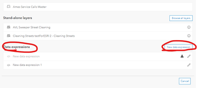

Hey Jay
you should look at creating a new Data Expression on the Serial Chart settings. You could then create a featureset on the fly , splitting your MONTH/DAY field(s) and get the results you are looking for. (the sample link could give you some good ideas as well)
Hope that can help you. Good luck!
