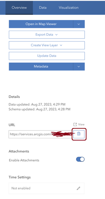

   The key with this is to learn what the service URL for a feature layer is so that you can swap it out in the map's JSON in AGO Assistant.
   Go to the feature layer's overview page, scroll to the bottom and locate the URL text box, as shown below. Click the button to the right of the text box to copy the service URL into your clipboard.

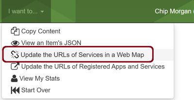

   Next, you can either edit the map's JSON in AGO Assistant to update the service "url" in the feature layer definition (which is pretty danged tedious, but doable) -OR- use the "Update the URLs of Services in a Web Map" as shown below.
   From the Update menu, locate the layer in question, replace the current contents of the text in the field, and click Update at the bottom right of the menu.
