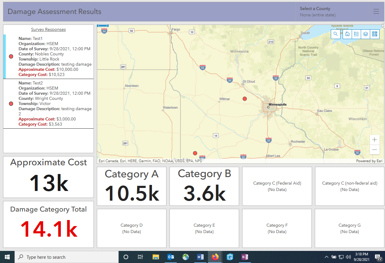

Here is a screenshot of my Dashboard in progress:
The Indicators for the damage categories just display a sum of that field. The "Damage Category Total" Indicator requires an arcade expression since I am adding together the separate damage category fields.

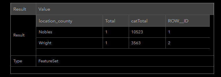

Which returns:

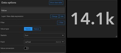

The Indicator
Now you have your FeatureSet. The indicator can be set to do the full sum:
Then on a category selector, list widget, etc., you can set a Filter action:
Drum roll, please:

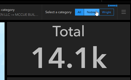

hsem_sturgill
Ah, need to make the GroupBy a variable. Nice. It sort of works, except it does not actually sum the different categories. I previously could never get the sum expression you posted above to work. Do you think it matters if the fs I set includes a non numeric field (i.e. county)? I'm guessing it does for the way I was adding together the categories previously.
I'll pick this back up tomorrow, thank you so much for the help so far!

Which returns:
The Indicator
Drum roll, please:
It's alive... it's ALIVE!It's alive... it's ALIVE!
