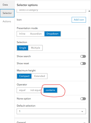

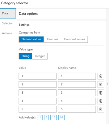

Neal_t_k
I think you can accomplish this by using Defined Values and Operator contains.  On the data tab or your category selector, pick defined values; you will have to manually set up all your values, then on the Selector tab in the operator section, choose contains.
