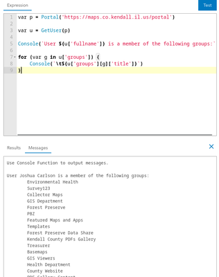

When you use the GetUser function, the object that is returned has a number of properties, not just the username. One of them is an array of groups.
Each group in the array has its own values, too.
How you use that list of groups and apply it to a filter depends on what you're wanting to do, but you could check the array for the presence of a certain group, or else just use the list of groups to filter by an attribute, etc.
- Josh Carlson

MuhammadNaufalIhsan
It works! Thanks a lot!
Although, getting group info from the array is quite tricky. But so far it works, so thank you again!
