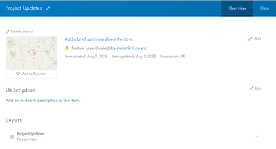

dwold
@DougBrowning no worries, I've enabled the sync setting in the item details and ensured globalids are enabled. Just strange behavior in the dashboard. Thanks for your suggestions. I'll keep poking around to see what might be the issue.
