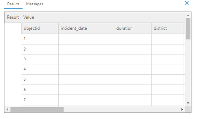

I have tried this 8 ways to Sunday and I can't get it to work.  This is the furthest I have gotten, and I am hoping someone can help me get the rest of the way.  We are operating version 10.9.1 on our portal server.
I am trying to create a data expression for a dashboard that is fed by Survey 123.  I am accessing the "Results" layer, and I own it.  Editing is enabled, but Sync is disabled.  All I really want to do is add 5 fields to the original and calculate them based on the incident date, I need to have the ability to aggregate on Year, Month, Day of Week, Hour and Quarter.  The calculations appear to be working, but the output comes out with a list of empty fields.

I have tried the above, I have tried populating a "features" array and feeding that to the dictionary, and I have tried the Push() function in a For Loop to push a feature into the Features element of the dictionary.  this is the only version that pretends to work, the features are going in/coming out, but not with all their attributes:
Thank you!!

EBurridge
Thank you @JohannesLinder! I changed just that row, and nothing changed about my output - it is all the same, about 2000 features with not a single populated attribute.
I then changed the field definitions in the dictionary to make the incident_date a numeric field, but that also didn't work.
Any other suggestions?
