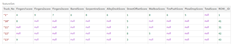

I have the following dashboard data expression that looks at the results (view) of a Survey123 form and groups by Truck Number and does some basic addition. The Survey123 form displays fields based on a parameter URL. Each station, such as Fingers 1, Barrel, or Plow Drop, has a QR code that determines the fields that judges see. All of the results are populated into a single HFL. We can can calculate a Total Score field using ArcGIS Pro but we would like for this to be dynamic in a Dashboard.

The featureset looks decent.
I'm running into two issues:
  1. The summed null values should convert to 0.
  2. TotalScore isn't working at all.
Any suggestions from the Esri Community?
Thank you!
