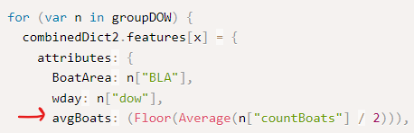

One additional note...towards the bottom for 'avgBoats', I have divided by 2 in addition to using 'Average' because each boat is scanned twice - once when launching and once when coming off water. I wanted to divide by 2 so each boat is only counted once, and then Average what was left.

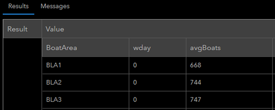

Here is a sample of the output:
Any help would be appreciated!

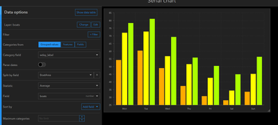

erica_poisson
Hi @jcarlson -
Thank you. So something in the code you suggest is not working properly for me once I get to the actual graphing portion. I was having this issue last week in my testing with trying to get this data expression to work:
You can see the value (y) axis is not correct - I end up with decimal values of 0.1 for everything. I do not really understand why this is happening.

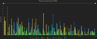

Also, to answer your question about the "sdate" field in my original script - this came from a separate data expression that I wrote so I could graph the count of boats per day of week through the entire boating season (April - October) so that we could have a sense of overall use trends throughout the boating season. I figured I'd use that as a basis for this "average use by weekday" data expression you are helping me with now.  The "sdate" field allowed me to include the date in the featureSet, and then I used that to calculate Weekday for each row in my featureSet.
The graph output of the other data expression (where "sdate" originated) is:
If you have the time or inclination...here is a View of the data I am working with if you are able to test this with the real data...https://mass-eoeea.maps.arcgis.com/home/item.html?id=faadbf5e0ef44523a8eb0d37adab33aa#overview
Thank you,
Erica
jcarlson
MVP Alum
Thank you! Always best to work with the real data. So, it looks like I made a couple mistakes above.
Many "dates" have a boat count of just 1, since grouping by a datetime will consider Monday at 12:30 different from Monday at 12:32. So we need to change the GroupBy expression to ignore the time. When it groups by date and time, those single-boat counts, divided by 2 and taking the Floor, is going to yield a 0. And then averaging a bunch of weekdays with 0s, you're going to get a small decimal.
So to get around that, we'll extract the year, month, and day in our GroupBy, in order to group per date regardless of time. We'll then use those values to cobble together a date for the Weekday function. And as long as we're at it, let's include a Decode function!

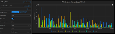

This is awesome! It worked perfectly. I do have a follow-up question however relating to what you mentioned above about time stamps.
Here is another data expression - this is the one that gives me a count of boat usage by day of week for the season. I am wondering if the fact that I did not strip away the time stamps here will result in an incorrect output. I'd be interested in your thoughts. This uses the same data as above.
The reason I ask...I took the graph which is generated by the script below and filtered for just "BLA1". I took all of the values provided for one day of the week (Saturday) and used the average function in Excel to see if the average was the same as what was provided by the graph I created using the script above - it was not (27.3 vs ~18 in Excel). Theoretically, I could add up all of the Saturday counts for BLA1, average them in Excel and get the same value as what the above script provides.

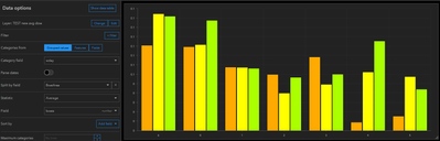

The chart is configured like this:
Thank you for your help!
Erica
jcarlson
MVP Alum
Can you try looking at other metrics as well, like the count, max, etc? Are those also inconsistent between Excel and the Dashboard?

For Saturday BLA1 -
  • AVG - 42 (Excel) vs. 27 (serial chart)
  • SUM - 1,145 (Excel) vs. 654 (serial chart)
  • MAX - 88 (Excel) vs. 64 (serial chart)
  • MIN - 4 (Excel) vs. 2 (serial chart)
You can see a public version of my current Dashboard here - https://mass-eoeea.maps.arcgis.com/apps/dashboards/0773a2c3a27b4690b8632b082e33690c
I am mystified by these differences. Also, I would expect that Saturday & Sunday would have a much higher average use per DOW as these are the two most popular boating days.
I would be interested in your thoughts on this.

I was able to resolve this - there were two issues.
First, within my data expression to get the Average Private Launches per Day of Week, there were two things wrong.
  1. The filter expression in line 4 was incorrect and I needed to update it to say "NOT Name like 'Rental%'" instead of "Not Name = 'Rental%'".
  2.  The count from line 16 is really the count of total survey scans - I need to drill this down to the number of boats. Since each boat has 2 surveys completed each day (for launch/retrieval), I needed to divide this value by 2 in line 31.

Next, within the data expression to get the Count of Private Launches by Day of Week, I needed to correct the Filter expression in line 5 the same way I did above. I also commented out some redundant lines within the GroupBy statement on line 7.
var portal = Portal("https://www.arcgis.com");
// Group the features by the BLA
var BLA = Filter(FeatureSetByPortalItem(portal,"###",0,['BLA_Used', 'Survey_Date', 'Name'],false), "NOT Name like 'Rental%'");
var groupBLA = GroupBy(BLA,
  ["Survey_Date", "BLA_Used"],
    //{ name: "BoatLaunchArea", expression: "BLA_Used", statistic: "MIN" },
    { name: "cntBoats", expression: "BLA_Used", statistic: "COUNT" },
    //{ name: "date", expression: "Survey_Date", statistic: "MIN" },
var combinedDict = {
  fields: [
    { name: "sdate", type: "esriFieldTypeDate" },
    { name: "dow", type: "esriFieldTypeInteger" },
    { name: "BLA", type: "esriFieldTypeString" },
    { name: "cntSurveyScans", type: "esriFieldTypeDouble" },
  geometryType: "",
  features: [],
var i = 0;
for (var m in groupBLA) {
  combinedDict.features[i] = {
    attributes: {
      BLA: m["BLA_Used"],
      cntSurveyScans: (m["cntBoats"] / 2),
      sdate: DateDiff(m["Survey_Date"], Date(1970, 0, 1), "MM/DD/yyyy"),
      dow: Weekday(m["Survey_Date"]),
  i++;
return FeatureSet(Text(combinedDict));
This resulted in consistent and verifiable results when comparing data between the data expression and Excel:
BLA 1 – Private Launches, Saturday
  • AVG serial chart = 18
  • AVG Excel = 17.88
