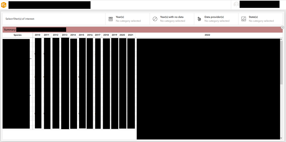

Hi,
Is there a reason (and a solution) for the last column of a Dashboard table (the right-most column) to be too wide when that table gets expanded?
Instead of distributing the width across columns, it is the last one that gets wider.

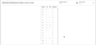

This is what the Fit to element width in UI option looks like with data center-aligned:
Here is the Fit to Data option with dummy elements to the left and right (allows resizing the table width), values left-aligned:
