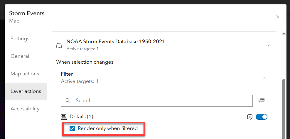

It's important to know how filters work. If I have a filter for 'thunderstorms' in my storm map, it is not adding thunderstorm features, instead it is removing all features that are not thunderstorms. Therefore, when you do not have any filters selected, the default behavior is to show all of the features, not hide all the features.
'No Data' means there is no data in the feature layer or that there is no features that match an applied filter. It does not activate when no filters have been applied. If you want your details element to display only when a point is selected on the map you have to check the 'render only when filtered' option when setting up your actions.
Actions configurationActions configuration

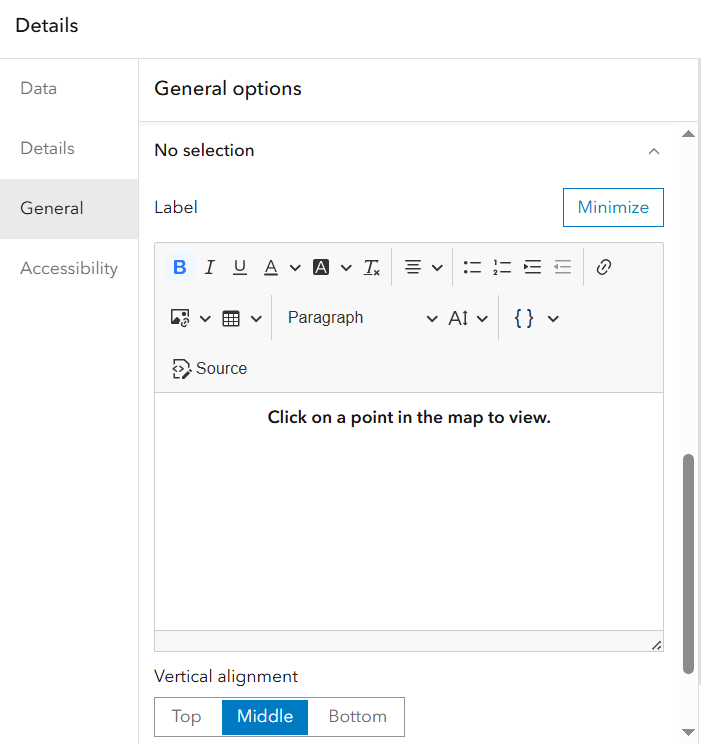

You would then add your custom message to the No selection box.
No selection configurationNo selection configuration

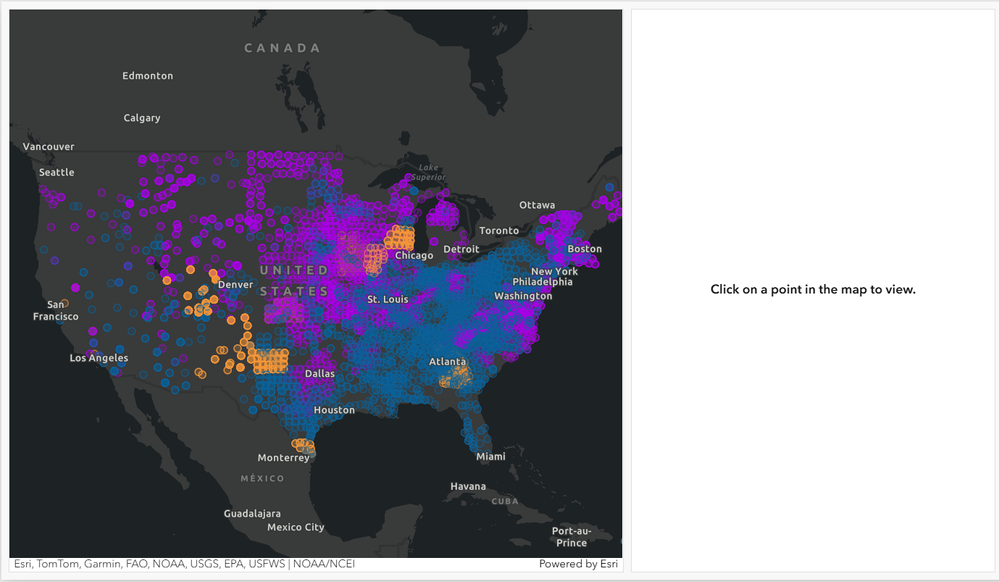

Dashboard with map and empty details pane.Dashboard with map and empty details pane.
