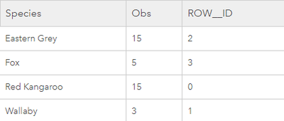

What I want is to use a data expression so I can transform the data to use indicator(s) eg:
SpeciesTotal
Red Kangaroo15
Wallaby3
Fox5
Eastern Grey15

JohannesLindner
MVP Alum
// load data
var input = {fields: [{name: "Site", type: "esriFieldTypeString"}, {name: "Species1", type: "esriFieldTypeString"}, {name: "Species1Obs", type: "esriFieldTypeInteger"}, {name: "Species2", type: "esriFieldTypeString"}, {name: "Species2Obs", type: "esriFieldTypeInteger"}, {name: "Species3", type: "esriFieldTypeString"}, {name: "Species3Obs", type: "esriFieldTypeInteger"},], features: [{attributes: {Site: "Little Swamp", Species1: "Red Kangaroo", Species1Obs: 5, Species2: "Wallaby", Species2Obs: 3, Species3: "Eastern Grey", Species3Obs: 10}}, {attributes: {Site: "Big Swamp", Species1: "Fox", Species1Obs: 5, Species2: "Red Kangaroo", Species2Obs: 10, Species3: "Eastern Grey", Species3Obs: 5}},], geometryType: ""}
var fs = Featureset(Text(input))
// flatten the table
var flat_dict = {
    fields: [
        {name: "Species", type: "esriFieldTypeString"},
        {name: "Obs", type: "esriFieldTypeInteger"},
    features: [],
    geometryType: ""
var max_species_number = 3
for(var f in fs) {
    for(var i = 1; i <= max_species_number; i++) {
        var new_f = {attributes: {Species: f[`Species${i}`], Obs: f[`Species${i}Obs`]}}
        Push(flat_dict.features, new_f)
var flat_fs = Featureset(Text(flat_dict))
// group by species and return
return GroupBy(flat_fs, ["Species"], [{name: "Obs", expression: "Obs", statistic: "SUM"}])
Have a great day!
Johannes
