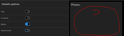

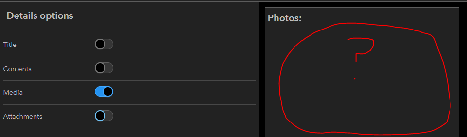

I would like to set up a details widget to display photo attachments, similar to how I had it set up in the portal.  When I try to do this in the AGOL dashboards the photos do not appear, see the first screenshot below.  I have the widget set so that it should show only "Media".

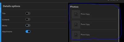

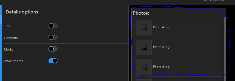

The dashboard however is recognizing that there are attachment photos. When I set the widget to show "Attachments" a list of my attachments appears, see screenshot below circled in blue. There are multiple photo attachments per feature.

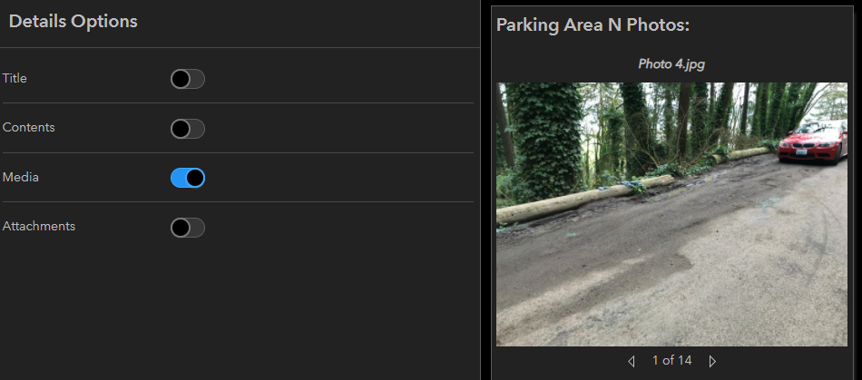

In the version I made in the portal the images display perfectly when the media option is enabled, as you can see below.

So this layer was coming directly from our local map server, not our AGOL account. I ended having the layer published as its own feature service and now, the lists option for attachments in the new map viewer can be switched to "Gallery". Now in the dashboard details widget, the attachments have a preview of the image.  It still does not allow you to view "Media" as stand-alone images, but with the "list" option changed to "gallery" in the popup options for the layer, and selecting "Attachments" in the widgets, it will display a preview of the image. For any future viewers that look into this issue - make sure your layer is a feature service layer on an AGOL account, or this will not work.

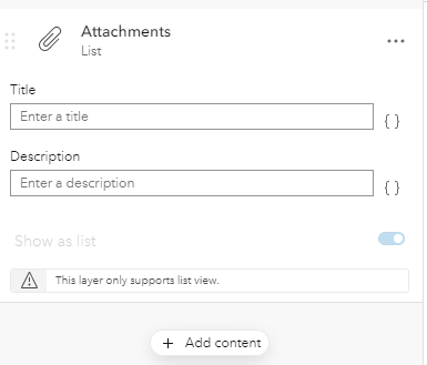

So initially the second workaround provided in the bug link looked promising. It read as "2. Open the web map in the new Map Viewer and toggle off the ‘Show as List’ option under the pop-up configuration for the layer." Unfortunately, when I went to do this my layer only supports list views.

I wonder what would cause that?  Maybe find out how your layer can be changed to support other types of views other list views.
