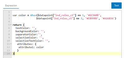

var color = When(
        $datapoint.division == 'Central Arizona', '#F3DED7',
        $datapoint.division == 'Northern Arizona', '#981e1d',
        $datapoint.division == 'Southern Arizona', '#f7b538', '')

JenniferAcunto
Have you double checked your Division values? You want to use the name value and not the label. Are you using the Globals tab to add your field to your expression? If not, do that so that you know the syntax is correct. Also, try returning it as an attribute and then simply calling that in your list. That way you can see what, if anything your statement is returning.
