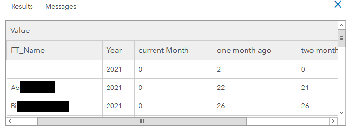

Merlin
Got it solved by the following expression (see result below). If there are any suggestions how to write a more elegant code, I would still appreaciate to learn it:

Merlin
