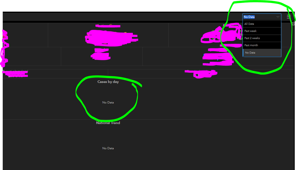

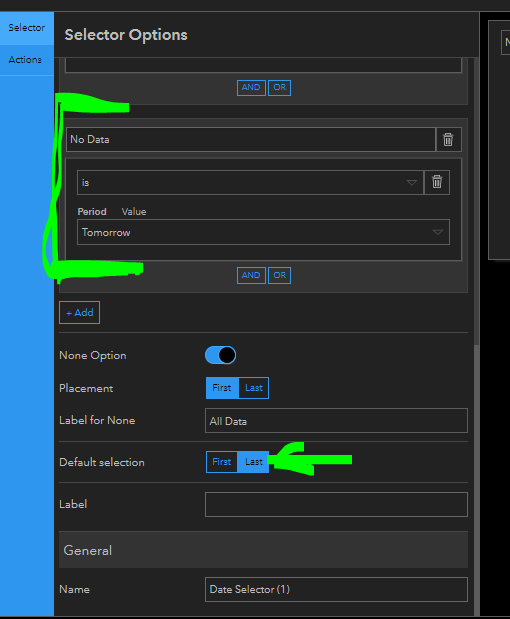

PanGIS
I received a notification for this thread and I see that I had already Replied.
The answer is the same either a side panel or the selector in the Dashboard Header.
    • Create a filter that filters only part of the data or No Data at all (in my case: Date is = tomorrow, . The result is 0 data.
    • then I set this last filter as default and on loading the chart is empty
