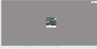

ArcGIS webmaps nor the dashboard gives me the ability to control how much the user can zoom out. As a result, no matter how elegant the map in my dashboard is, when a user zooms out to an exponential level, it makes a very silly looking map. See image below. ESRI, please do something about this. I am crying!

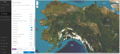

@RickeyFight Thank you for sharing the link above. Looks like this is outdated as of 2021. I went through the steps to try to solve my problem. I ran into two things.
First, the minimalist app is no longer offered. So instead, I went with the Media Map. It turns out, they have taken out the "Navigation Boundary" feature entirely. See my screenshot below.
