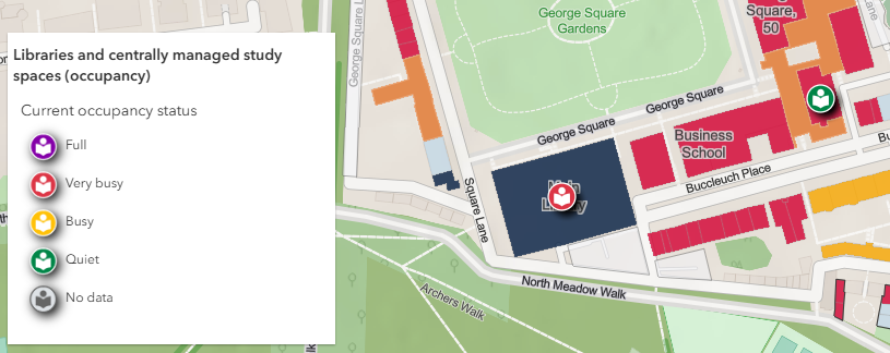

Screen grabs of my scenario below that hopefully explain the issue.

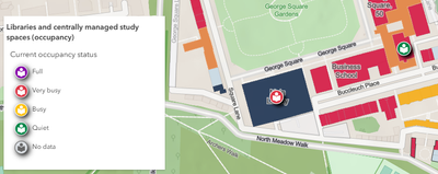

My dataset of libraries has two attributes: capacity (integer) and current occupancy (integer). In the web map, I have configured the libraries to be displayed with a colour based on how busy the library currently is (this is calculated by working out the current percentage occupancy ((currentoccupancy/capacity) * 100) and then classifying the value in to 'quiet', 'busy', 'very busy', 'full', and 'no data'):

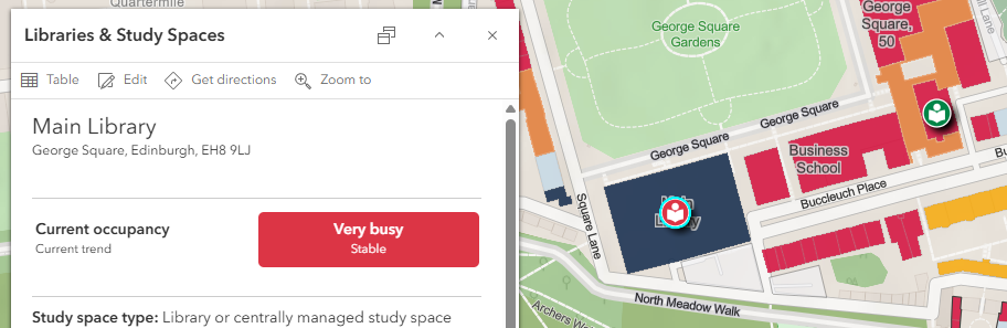

This information is also displayed in the popup using an Attribute Expression:

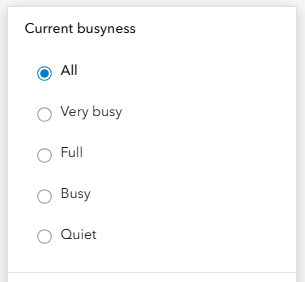

What I want in the Dashboard is the ability to configure a Category Selector to allow users to filter the map data to just show those libraries that are currently 'quiet', i.e. something like this:
From what I can tell, there is no way to do this even though using simple attribute expressions to display data in web maps is a really common way of presenting data.
