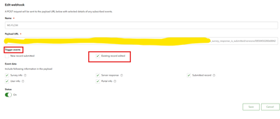

You can use the "survey is submitted" connector but in the webhook settings (within survey123) you can just have the webhook trigger on "Existing record edited" and leave the "New record submitted" ticked off.
The flow will only trigger when a record is edited and not when it's submitted for the first time.

I will definitely take a look at this. If I understand you correctly, I would still use the "When a survey is submitted" trigger, but since the webhook for that trigger is set to existing record edited, it will actually trigger the flow when something is edited?

I did that, but still nothing. When I had the webhook only trigger when an existing record is edited, it never triggered the flow. I then turned on the submitted trigger in the webhook and added a submission, and it worked immediately. I am stumped as to why the edit trigger doesn't activate.

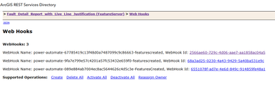

If you add the "when a survey response is submitted" trigger, you will be able to see the webhook in the Survey123 page.
If you use a feature level trigger like "When a record is created/updated in a feature layer" you will NOT see in the Survey123 settings page. You will need to check it in the REST endpoint of the feature layer.
Edit - Use the Admin option to see the webhooks option

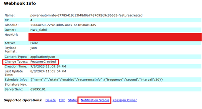

In that section you can check to see if webhook is created for "When records are updated"
You will also be able to see if the webhook is trigger okay (or the errors) under the notification status.
