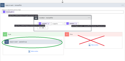

I would imagine that this is similar to working with a new survey submission though, in that you need to compare uniquerowid to parentrowid in a nested Condition within your Apply to Each. All of your operations would be on the "yes" side. E.g.:
In the above, "transect_plot" is the repeat, "uniquerowid" is from the main layer, and "parentrowid" is within the repeat.
