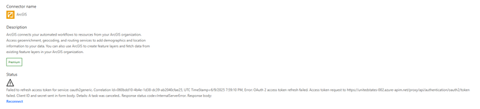

Jamie_Leitch_CNF
@NataliyaLys I'm seeing the same.  Also when I go to the Connections page in Power Automate, I see this:
And when I click Reconnect, a window pops up and appears to sign into AGOL again and in shows "Connected" on the connections page.  The page will shows "Reconnect" again if I refresh it after a while.

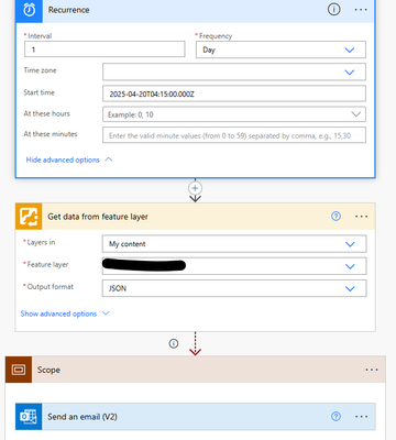

I created a flow in MS Power Automate to hopefully mitigate any more issues with this.  Here is what I did.
  1. Create a cloud flow that is triggered by Recurrence and set it to run daily.
  2. Add a step for ArcGIS - Get data from feature layer.
  3. Choose a feature layer from your content that will never be removed.

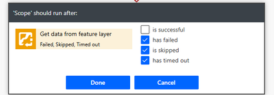

  4. Add a Scope Control action and configure the Run after settings to be: has failed, is skipped, has timed out.
  5. In that Scope Control add a "Send email" action to email yourself.  This way, if the connection to ArcGIS times out or fails, you will get an email.  When successful, this shoulda also update the security token for the ArcGIS Connectio.
hopefully this helps
