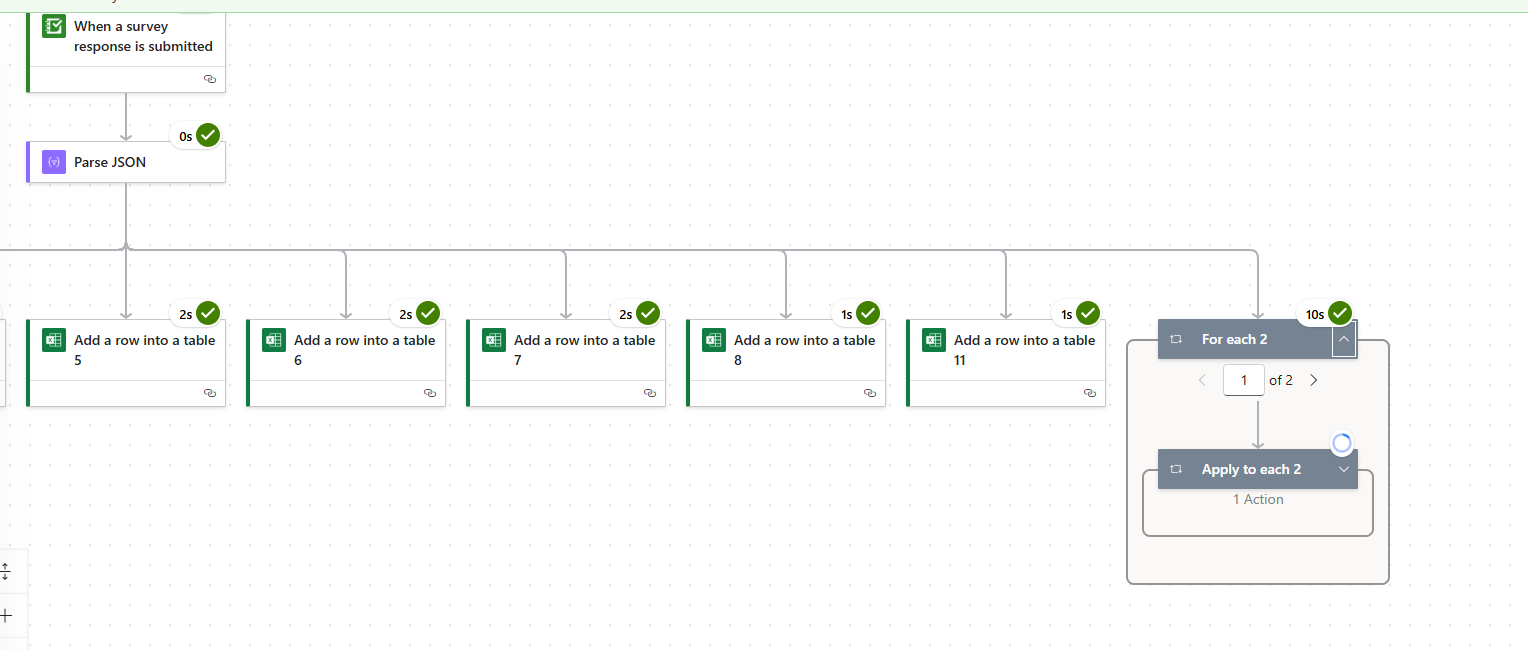

I am trying to create a Power Automate flow to populate data from a submitted Survey 123 form into an excel sheet on Sharepoint. I have most of the flow working, but I am having some trouble when I get to the repeats from the survey. I have added a "For Each" Action, followed by an "Apply to Each" action, then followed by an "Add a row into a Table" action, which seems to be the recommended workflow.
In the test survey, I added 2 repeats, just to make sure that the repeats were coming across correctly. For example, the group I have repeated is called Power Poles, so I can submit information for several poles in the field.
However, when the flow runs, I am not just seeing the 2 records for the power poles in the Excel sheet, I am seeing 4 records outputted, with 2 of each submission populated. Please see the photos for more information. How do I get each record to only show up once in the table? I have tried re-doing the flow several times and can't crack it. Thanks so much for any help!
tschrage
Can you use the "List rows in an excel table" action to list the rows that exist prior to the parse json action so you know what rows exist and only add the rows that don't exist in the table?  If there is a unique identifier for each power pole, that would aid in tracking your duplicates.
