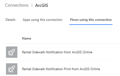

DominicRobergeIADOT
I have no Fix Connections next to it, and both of my flows are using the same connection
