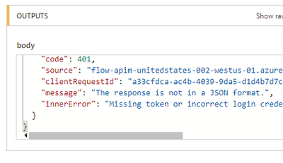

I'm new to Power Automate, started using it over a month ago. I have a number of flows set up, all using ArcGIS online connector. Yesterday  I noticed that all my flows failed. The errors that I got looks like token expiration issue.
I reset my ArcGIS online connection and 'resubmitted' each flow, and so I'm back to were I started. Kind of.
The problem is that I have some flows that get triggered when feaure is created. So even if I fixed the connection issue, I'm now left with features that were not updated by power automate (power automate assigns some values to features when they get created) and email with updates didn't get send, since the flow is triggered on feauture creation.  I wonder if there is some work around for this.
Is there anyway to get notified then the token gets expired? Because if  I wouldn't have checked, i would have never known that it expired. Hopefully in a day or two some of my users would have notified me that they are not getting emails, that power automate is supposted to sent then features are updated.
Appreciate any ideas suggestion on how to handle the token expiration issue.
