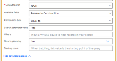

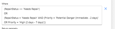

tschrage
You first set your trigger to when a record is updated in a feature layer.  Next use an action to "Get data from feature layer."  Within that action you can filter out only the data you want to see by using the Search Parameter, comparison type, and available fields..... or by using a complex expression in the "Where" option.
Below is just a couple examples of some of the things I've done.

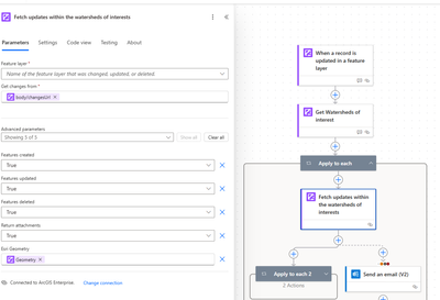

AkshayHarshe
@GBPTechForester  I think above comments are great and you should start there. Just letting you know that. Our latest release is now rolled out by MS so `Get Data from Feature layer` action can now do whole lot more. Also, you Can now restrict the the Fetch action by `Esri Geometry` to get information only from the geometry of interest.
For example in the screenshot below I am listening to a record is updated in the feature layer (stream quality) --> Getting the watersheds that I am responsible for --> Restricting the Fetch action by the watershed geometry. So it will only run the next actions when the changes are inside the watersheds.
Thanks,
Akshay Harshe
