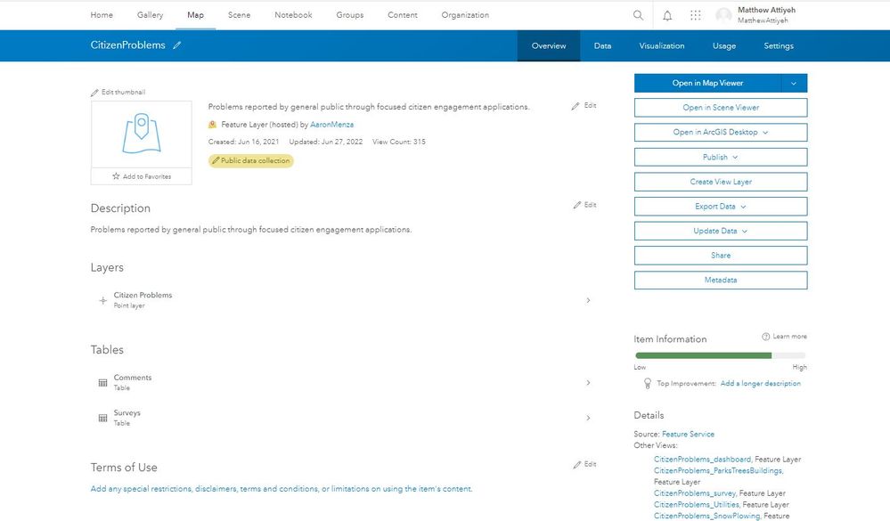

When I originally set up my flow I selected the layer form a dropdown in power automate from the ArcGIS connector. Just now I grabbed the feature Layer Id from the completed power automate record and when I looked that up in our system it shows up as a feature layer (not a view) but when I copy the url from that page into a browser it shows up as a featureServer with a different ID but shows the Service ItemID is the correct one (5fee9021128f4eb28efefc0b0e7ce024). I attached a couple screenshots to show you what I am talking about.
Let me know if that doesn't make sense but to me it looks like it should be connected directly to the feature layer right? Is there something I am missing? Should I actually be connecting to something else?

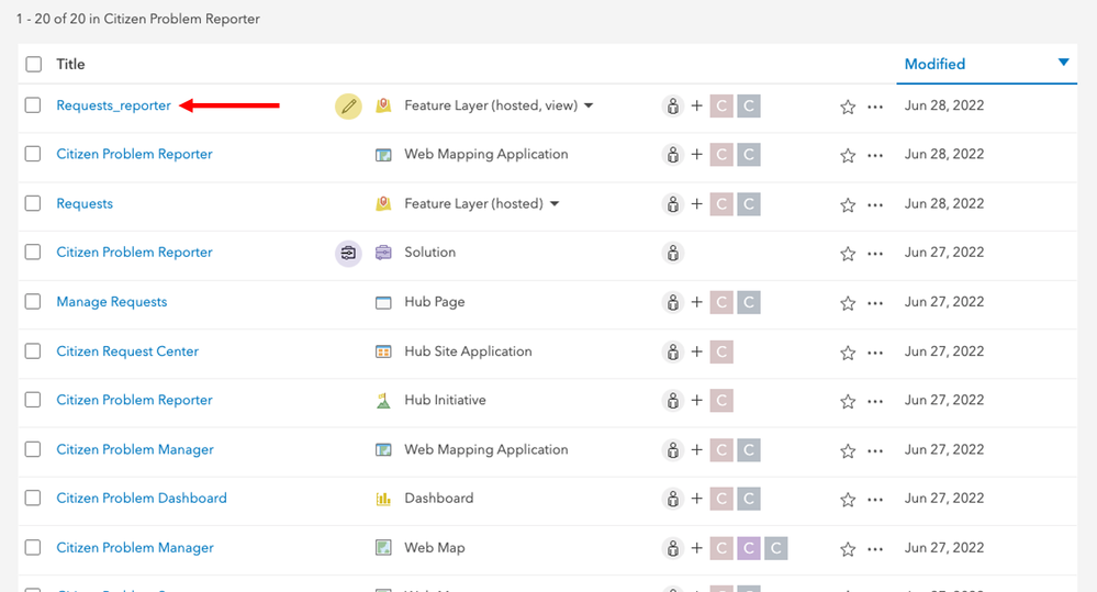

The feature layer that worked and fired the webhook was the 'Requests_reporter' which is a Feature Layer (hosted, view).
The red arrow is pointing to the feature layer view that is edited when a request is submitted through the Citizen Problem Reporter solution.The red arrow is pointing to the feature layer view that is edited when a request is submitted through the Citizen Problem Reporter solution.

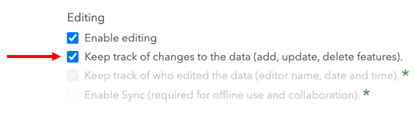

The next step was to confirm the 'Editing' settings are correct. For Power Automate to catch the web hooks, the 'Keep track of changes to the data (add, update, delete features)' must be selected. Initially it was not checked in the initial deploy of the Citizen Problem Reporter solution.
Make sure the 'Keep track of changes' check box is selected.Make sure the 'Keep track of changes' check box is selected.

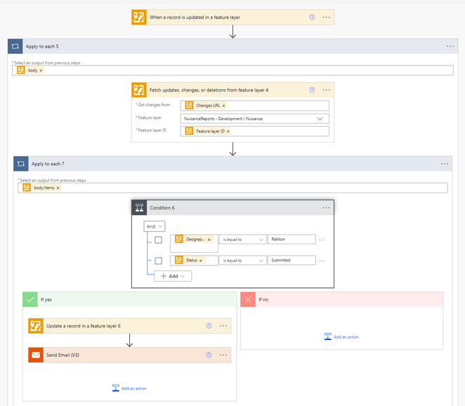

I'm also trying to set up Power Automate to send an email notifictions when reports are submitted through ArcGIS Citizen Reporter application. And I'm running into an issue with one of my flows.
Here is my workflow:
1. Report is added through the citizen reporter
2. Status value 'Submitted' is assigned by default, when report is created
3. I have a python script running every 5 minutes, the scripts checks all new features added and based on location of the feature, it calculates' Geographic Assignment' field for each added report
4. Once 'geographic assigment' field is calculated I would like my Power Automate Flow to run, and make some aditional updates to the feature, and then send an email.
5. The flow is getting triggered, but it doesn't seem to pick up the edits so condition is not met and email is not getting sent.
I cannot figure out why the flow is not recognzing the update to the 'Geographic assignment' field?
A side note, the flow will run if I manually edit one of the fields (after 'geographic assignment' field was already populated)
Here is my Flow:
